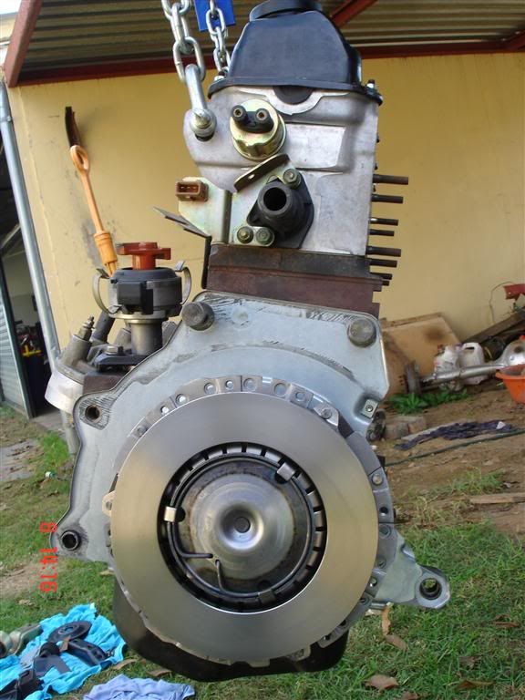

My bro's CTi clutch was riding so decided to do the clutch on the car.
Fitted a sachs 210mm clutch and pressure plate, push rod and releaser bearing aswell.
Problem now is that there is very little or no clutch at all.
We adjusted the cable upwards and down but still nothing, plus you can't get any gear when idling, and if you force it, it will go but although the clutch is still in, the car will just move forward.
Don't know what else to check up, any info will be appreciated.
In abit of a situation here

Re: No clutch
Point 5 refers to that long oush pin that actaully actuates the clutch.
