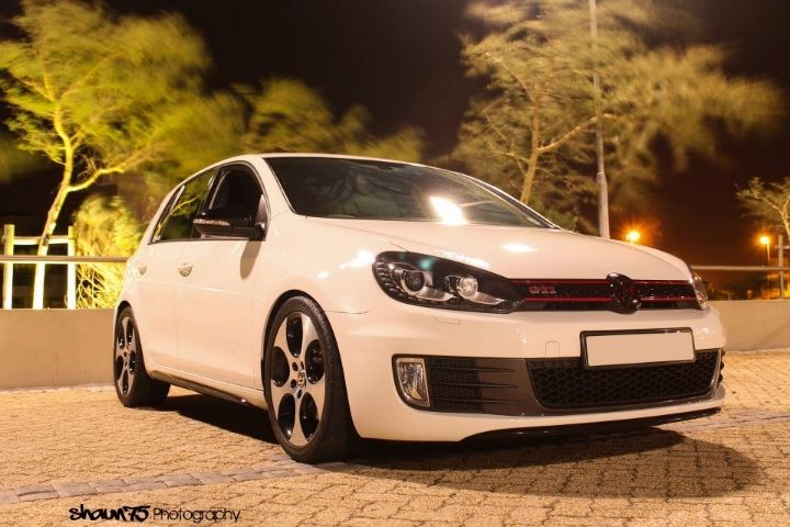

I have the DG springs and the rear gap is slightly more, I have 1 finger gap in front and 2 at the rear.
My car stock was slightly higher in the rear, so it dropped it evenly.
This is mine on the DG's...
