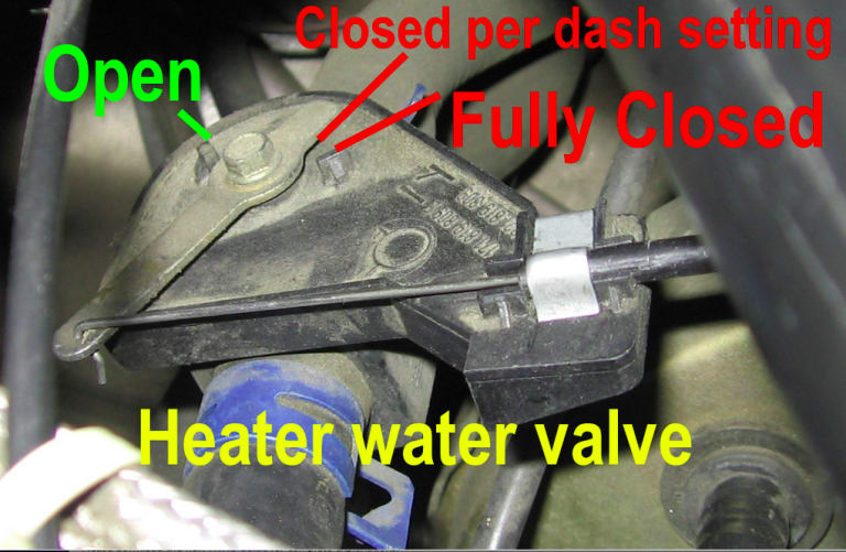

This is the valve on the pipes described above. It's likely been removed too.

thanks Belix for this info and video , yes i notice my water heater valve has been removed , i will need to purchase another one and also check the piping , maybe a garage that installs aircon can assist me , not sure , thanks once again

Before you buy the valve, operate the dash lever and see what happens with the cable in the engine compartment at "open" (hot) and "closed" (cold).
Then make sure you get the appropriate valve. I've seen some that have the open and closed positions switched around.
